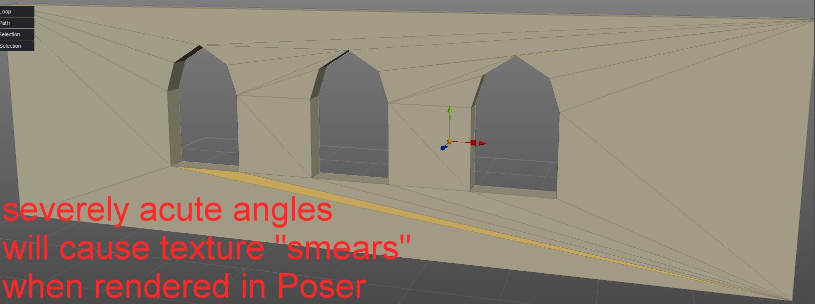

     Here's a modeler screenshot of a wall after three arched window openings have been Boolean cut, and then the surface triangulated.  I have highlighted two examples of "slivers", one of which is so acutely angled that it appears to be only an edge, though it is actually a very thin triangle.  If UV mapped and then rendered in Poser, this wall would show blurry smears in the texture, near the "slivers". ![slivered polys](http://img.photobucket.com/albums/v604/seachnasaigh/tutorials/wall_BooCut_slivers.jpg)
      After making a Boolean cut, manually re-build the wall surface with gently-angled quads.  Poser will render this wall perfectly.
