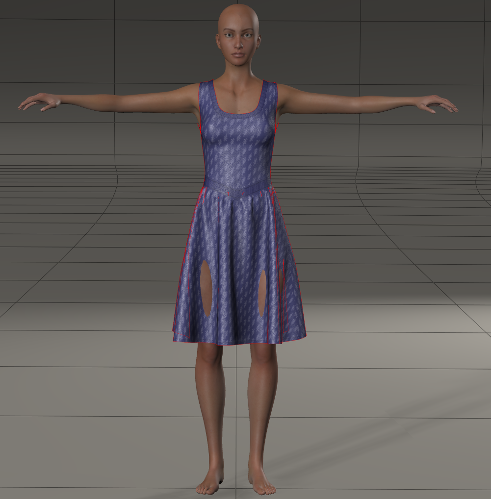

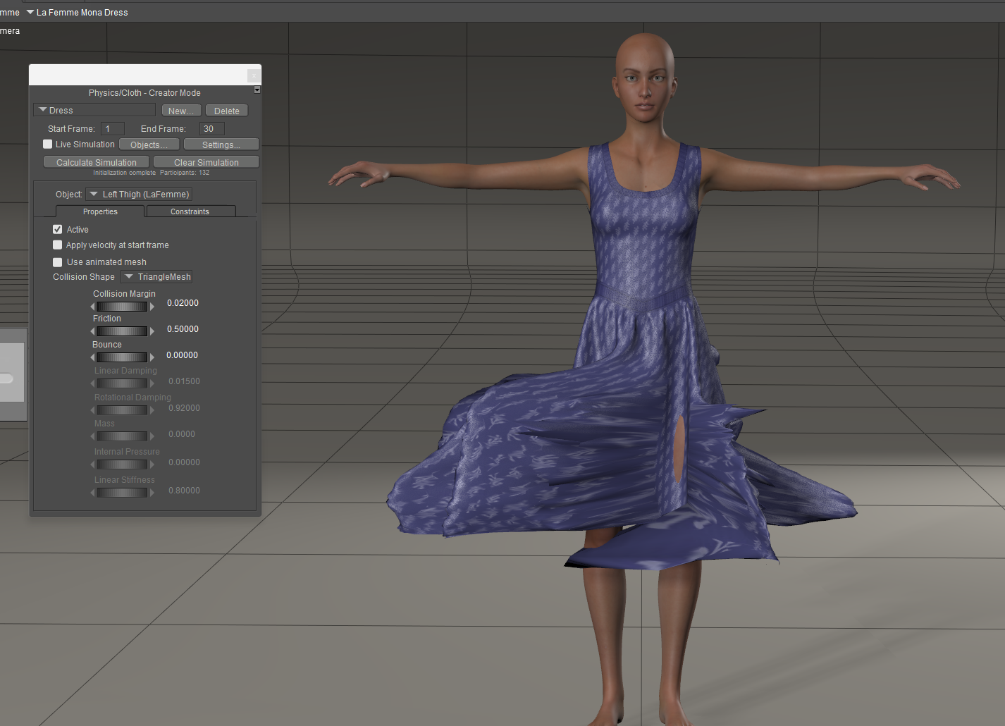

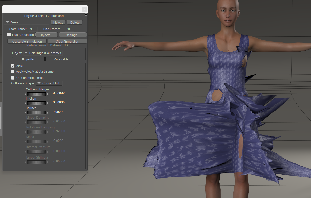

I just changed the Collision shape to TriangleMesh to see if that would help (just noticed it as an option) and while it's better further up the dress, the same issue overall, stuck to the leg.

Thanks Tim.@skybluerob - be sure to include the Left & Right Thigh in the simulation under Objects... & increase their Collision Margin property to push dress off the thighs.
There should be a new free update out next week with improved simulation defaults & a Smooth Frame option to auto fix poke-thru, etc.

I tried doing that, and cranked it up a bit too high to see if it would resolve it, but the part where the leg is showing is still poking through. It's almost as if once the leg pokes through, it remains there no matter what. I've tried adjusting the glue too and that doesn't seem to help either.
Hopefully the update will help. As I say, it has potential and seems to be a fair bit quicker to calculate than the cloth room from what I can tell. If it can work on existing dynamic clothing then bingo.

I can't seem to make this work propoerly either.
There's potential there, but no matter what I do, the legs are always poking through.
And the more I change the other dials, the worse everything else becomes. I followed the tutorial in this link Usage Tutorial
I think the developers need to take another look at the legs, but at least some form of cloth room replacement is being offered, and it's not too dissimilar to what we had before.
(I'm using La Femme 1 and the Mona Dress, both of which come with Poser 13 (I'm currently using the trial for Poser 14).
