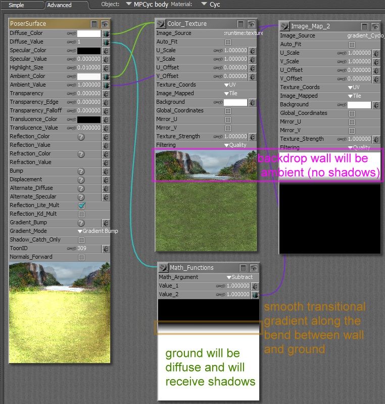

seachnasaigh posted Sun, 20 June 2010 at 9:08 PM
Attached Link: cyclorama gradient
This isn't anything fancy, but I use it frequently to avoid having an -ahemmm- embarrassing  shadow on the backdrop wall of the Cyclorama, while retaining the shadowing on the ground.  I thought someone else might want to use it. ^^ ![differential shadowcatching](http://img.photobucket.com/albums/v604/seachnasaigh/tutorials/P8_shadowcatcher_gradient.jpg)
demo using a mucho-mojo'ed Cyclorama;  notice that the huge tree's shadow fades away as it approaches the backdrop wall:
Miri's treehouse
Hotlink is for the gradient image.

pjz99 posted Sun, 20 June 2010 at 11:25 PM
Quote - This isn't anything fancy, but I use it frequently to avoid having an -ahemmm- embarrassing  shadow on the backdrop wall of the Cyclorama, while retaining the shadowing on the ground.  I thought someone else might want to use it. ^^
That's a pretty clever trick actually.
