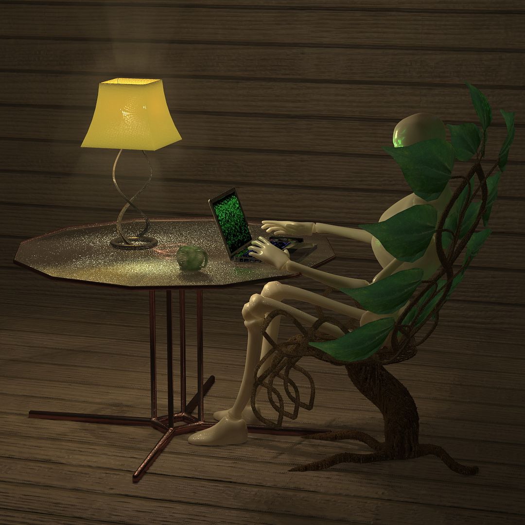

bagginsbill posted Sun, 02 June 2013 at 12:30 PM
This image is lit exactly as you are doing with a point light, but three times as many because I have three lamps and three point lights. There is one in the ceiling (outside the framed composition, but it's there) and there are lights in each of the bedside lamps.
It looks right because:
IDL is on
GC is on
all my shaders are accurate
Renderosity forum reply notifications are wonky. If I read a follow-up in a thread, but I don't myself reply, then notifications no longer happen AT ALL on that thread. So if I seem to be ignoring a question, that's why. (Updated September 23, 2019)
seachnasaigh posted Sun, 02 June 2013 at 12:46 PM
     If the lampshade has thickness, I'd give it SSS and a little translucence.  For the bulb,  I use both a point light and an IDL emitter, with one mesh as the visible prop, another mesh -slightly larger- as an unseen IDL emitter with an ambient of maybe 70, and a third considerably larger mesh as the faintly visible glow aura.
bulb
     For the lampshade, I might add lightshaft meshes and a rounded-off aura mesh.
shade meshes.
Bare bulb as rendered:
bulb.
...and with lampshade:
lamp.
Poser 12, in feet.
OSes:  Win7Prox64, Win7Ultx64
Silo Pro 2.5.6 64bit, Vue Infinite 2014.7, Genetica 4.0 Studio, UV Mapper Pro, UV Layout Pro, PhotoImpact X3, GIF Animator 5

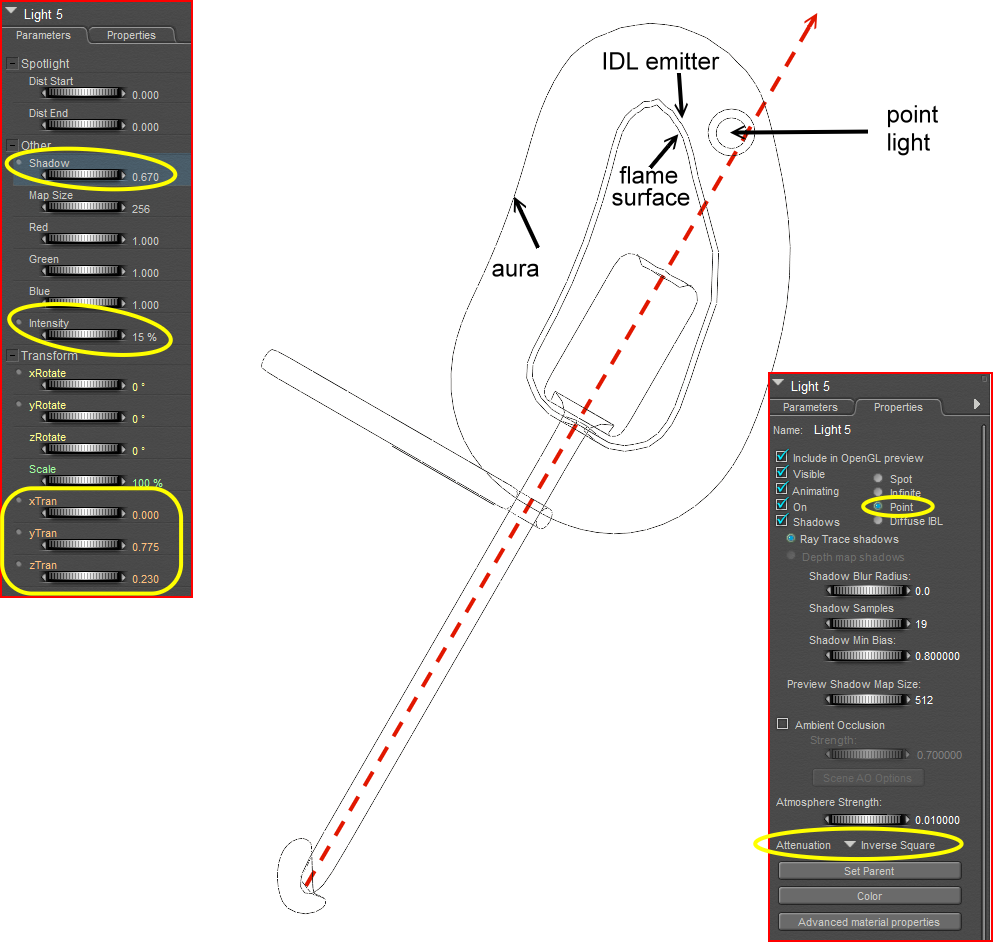

seachnasaigh posted Sun, 02 June 2013 at 9:09 PM
     Well, Firefly's IDL was intended to account for passive bouncing of light.  To simulate  things which are active light emitters, you need to fudge a bit.  Thus, one mesh for the visible prop, which will have only a gentle ambient (half, two-thirds, at most 1) so that the visible prop retains a realistic color and allows a perception of shape and depth.  If you give the visible prop too high of an ambient, (5, or 20, etc) then the prop flattens out as a white silhouette.
     That is why I use a separate -and unseen by camera- IDL emitter.  The emitter prop can have an ambient of 5, or 50, whatever is needed to effectively cast light.  The greater the surface area of the emitter, the lower the ambient intensity needed, and the less splotchiness for a given render setting.  Rendering with gamma correction will also tend to lighten and even out the lighting in a scene, so I'd recommend that you start using it.
     For your lamp, I would use a high-ambient bulb emitter that is perhaps twice the diameter of the visible bulb, and a low-ambient emitter closely fitted around the lampshade, since lampshades are generally somewhat translucent -not opaque- and so the shade should give a little light also.
     All of this extra unseen mesh nonsense complements the point light by casting light from a volume.  A lightbulb in a translucent lampshade doesn't cast light from a single point, does it?  No, it casts light from the filament, the entire surface of the bulb, and -more gently- from the surface of the lampshade.
     If you use only a point light, the shadows will be grossly unnatural.  If you use only concealed IDL emitter meshes, the light will be dull, lacking specular highlights.  Use both.   Concealed IDL meshes combined with Poser lights have synergy, symbiosis, ...something like that.  They each compensate for the weak points of the other.   Bring the full arsenal of Poser lighting to bear, and the total effect will be greater than either of the components used alone.
Ye olde medieval wall torch example:
torch.
Poser 12, in feet.
