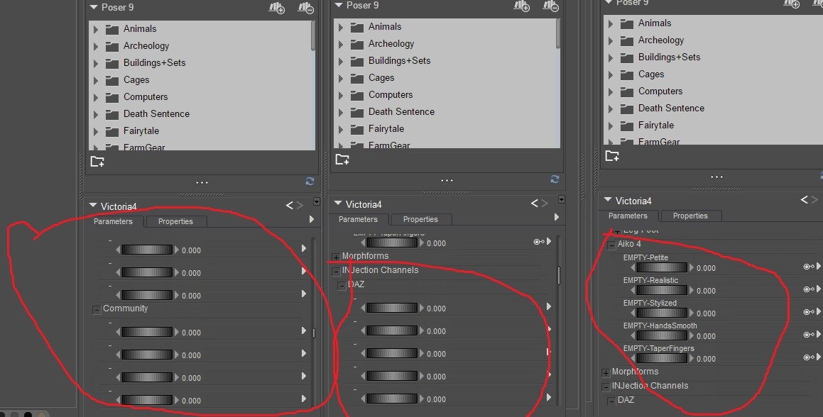

I opened up Poser tday and found this:
I've seen blank space before, but this just suddenly happened and wasn't present the last time I opened these files. I checked my other saved files and found the same thing.
Anyone know what caused this and how to get rid of it?

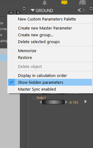

RedPhantom posted Wed, 21 January 2026 at 1:22 PM Site Admin
Vicky has a bunch of hidden slots for injecting the morphs into. They will show up when you have the Show hidden parameters checked. On your paramiter's pallet look in the drop down menu. Uncheck that option, and they should go away
