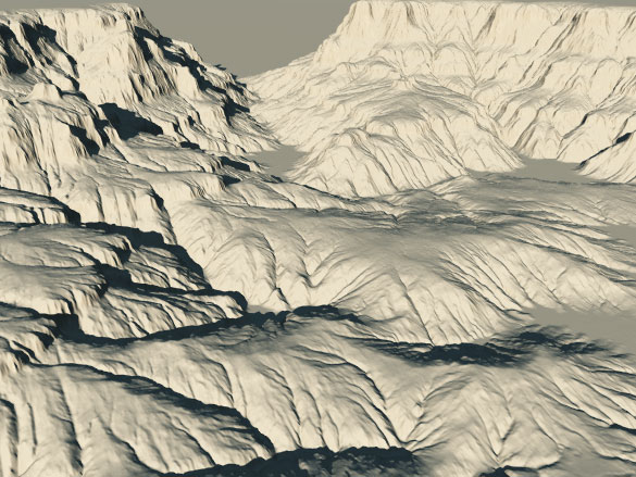

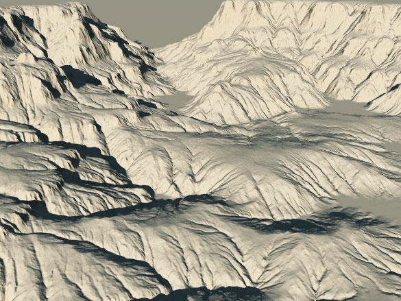

offrench ( ) posted Wed, 28 May 2008 at 1:59 AM · edited Wed, 28 May 2008 at 2:00 AM
 To show the difference, here is an example with the same image file.16 bit tiff, 2048*2048 size. The procedural one looks a bit different due to the 1.01 resize.
Bitmap
Procedural

Xpleet ( ) posted Wed, 28 May 2008 at 2:43 AM
cajomi/offrench is right.
I've beein using procedurals imported all the way. It gives almost 1/1 resolution.
chippwalters ( ) posted Wed, 28 May 2008 at 3:01 AM · edited Wed, 28 May 2008 at 3:03 AM
The difference is subtle, to say the least. I suppose I'd trade-off the apparent less detail for a nice increase in render speed. Plus, a small procedural bump map added to the standard terrain will help sharpen it as well.
I assume you created a 2048x2048 sized terrain to apply the bitmap to?
offrench ( ) posted Wed, 28 May 2008 at 4:58 AM
Yes, I used the same file and the "classic" terrain resolution is 2048*2048.
I think there may be more differences with 4096 maps or if you zoom on the terrain a bit. But it is true that with a proper texture, there might be few differences.
I will make a series of benchmarks with or without textures to see which option is the best in terms of quality / render speed.

Xpleet ( ) posted Wed, 28 May 2008 at 9:52 AM
Actually the difference is very subtle but you can see very small features more clearly outlined in the below picture.
And don't forget to turn highlighting off for your terrains!!!!
