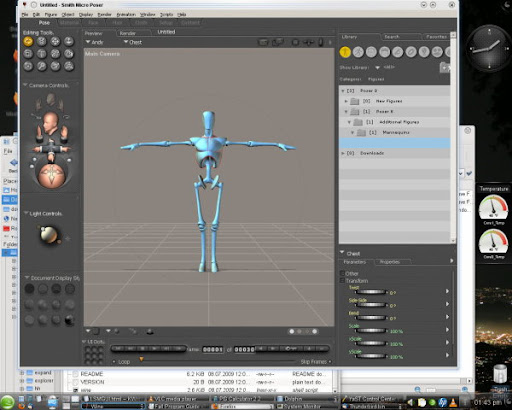

Poser 8 running under Wine 1.1.27 with Wine-Gecko 1.0 on the KDE 4.3 desktop:
Library looks nice; unfortunately it doesn't work.  I'll tell you how I got it there, tho'...
To get aroung the Gecko local SWF file bug I used the Windows version of Mongoose 2.8 webserver to host the LMSGUI bin-release folder (I left the port at the default 8080).  I then edited the LMSGUI.html file to change all references of 'LMSGUI.swf' to 'http://127.0.0.1:8080/LSMGUI.swf', changed all of the allowScriptAccess variables to "always"(not sure if necessary, but it seemed prudent), and added 'FlashVars="apiUrl=http://127.0.0.1:11530/apps/lms/api.py"' to the final embed section.
The modified file works great in Firefox, but within Poser (and iexplore.exe) it opens the Library, but the content icons and names are not there and the top tabs don't work, so I've discovered another bug in Wine.
Here's my Wine Applications Database Report on Poser 8.0.
