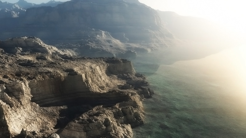

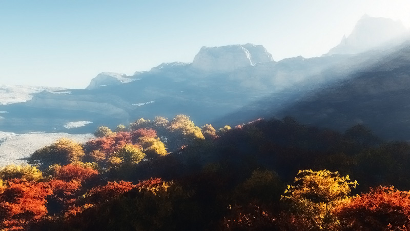

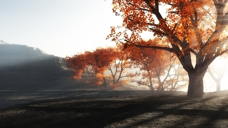

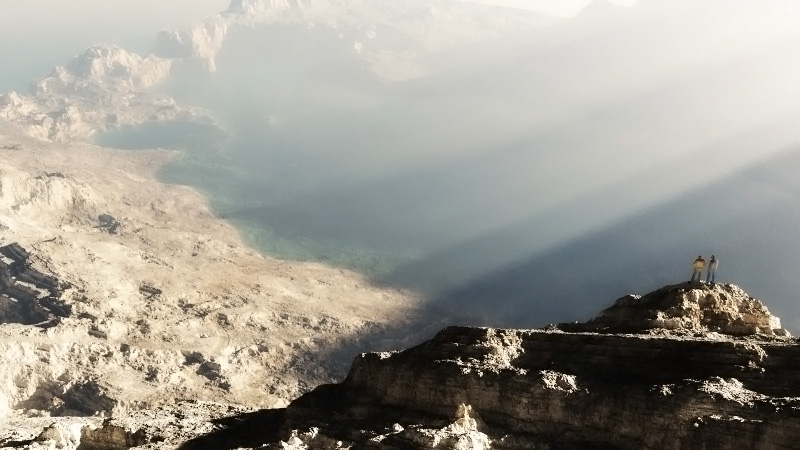

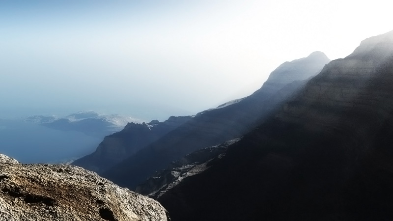

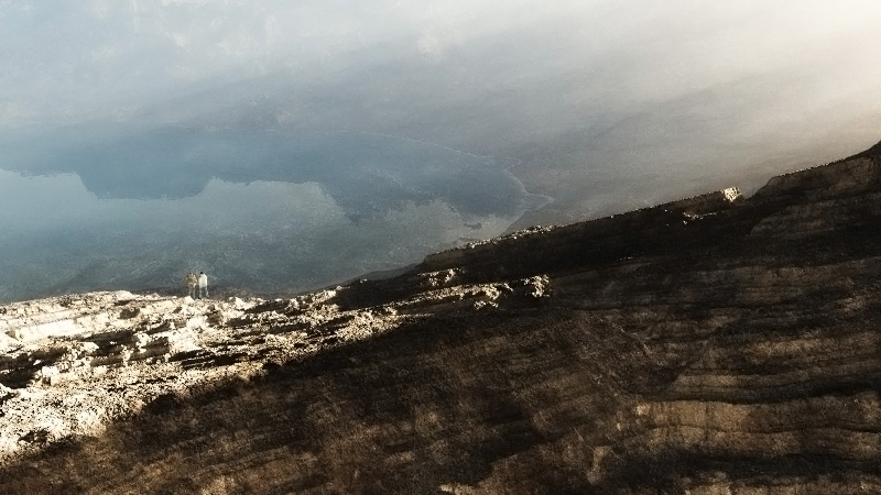

 Recently I've been playing around with the Vue 8 beta, and I have to say I'm impressed! Lot's of neat new features including the new Strata filters, displacement map overhangs and super God Rays. There seems to be a certain crispness I haven't seen before for the landscape fractals-- sorta reminds me of Terragen renders. Here are a few of the test images. If you're on the fence about upgrading, maybe these will help you with the decision. ;-)

No, they don't take more time to render than before, displacement is even faster, and cleaner. The strata filter is indeed in the function editor, it's a filter like any filter you basically place between the fractal input and the altitude output. But there are other ways to use it of course.
Chipp, those godrays are wonderful, and you didn't say that you don't even need clouds anymore to get them, like your 3rd example shows, you can get crisp godrays through tree branches.

To get rid of noise in Godrays, I used an old trick of Dave Burdick's: up the anti-aliasing to something like 95% quality and it really helps. I believe some of the scenes above will come with Vue 8, so you will be able to study them directly if you purchase an upgrade.
