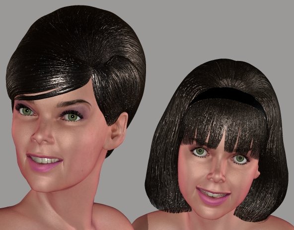

JOELGLAINE ( ) posted Wed, 03 March 2010 at 7:58 PM
 So that's your Barbara Gordon morph on Antonia? One on the left?

Cage ( ) posted Wed, 03 March 2010 at 8:35 PM
Quote - So that's your Barbara Gordon morph on Antonia? One on the left?
Hopefully that's where it's heading.  :lol:  Trending in that direction.  Half the time I can't tell if it resembles her or not.  The actress seems to have an odd face which looks almost like different people when comparing various photos.  I think it's her cheeks.  Very muscular cheeks, which change the shape of her face depending on whether they're relaxed or not.  Hmm.
Umm.  Shorter answer:  Yes, it is.  :lol:

JOELGLAINE ( ) posted Wed, 03 March 2010 at 8:48 PM
 Looks like her to me. Some people just have elusive,mobile faces that are to rig in 3d programs.
Great likeness. She looks good on Antonia!

Cage ( ) posted Wed, 03 March 2010 at 11:53 PM
Thank you.  I've been trying to get a resemblance since... (counts on fingers) 1999.  And I've been working on morph transfer since 2006.  As I've said, I work verrry sloowwly.  :lol:
