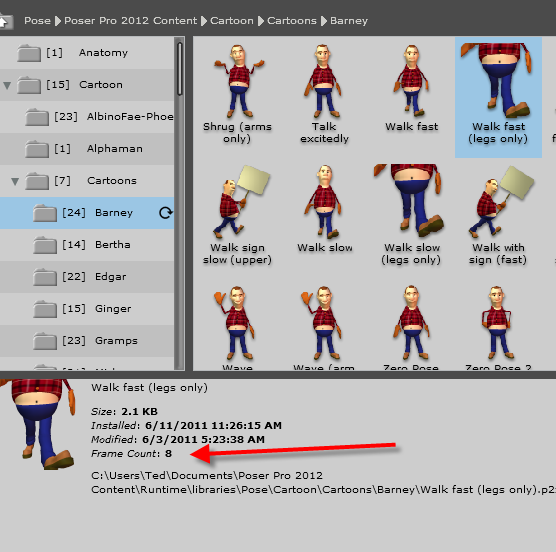

Poser has an obligation (self-imposed but there nonetheless) to show you the frame count on animated pose files. In order to do that, it has to open and examine every PZ2, just in case it is animated.
Now what would you think the cost of listing, opening, and reading every file (PZ2) would be versus just listing it (MC6)?
