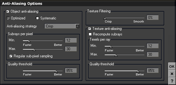

This is something that has been bugging me for some time. I generally find that Vue antialiasing is too strong, especially on rocky materials.
I have tried the following things:
  • Crisp antialiasing and better quality. This is effective on most items (including plants), but rocks still look too smooth.
  • De-activate antialising on material. Makes the whole scene look crappy, including elements that are near the rocks. It would be handy to be able to de-activate antialiasing on a sub-material, but alas it is not yet possible.
Is there another trick or should I merely add more bump to my material?
Below is the scene I am working on
And the antialising settings for this render
Fantasy pictures, free 3d models, 3d tutorials and seamless textures on Virtual Lands.
bruno021 ( ) posted Fri, 07 March 2008 at 5:20 AM
I think this isn't due to AA settings, but material size and bump being too low. Try changing material size to something smaller, and up the bump to get more definition.
