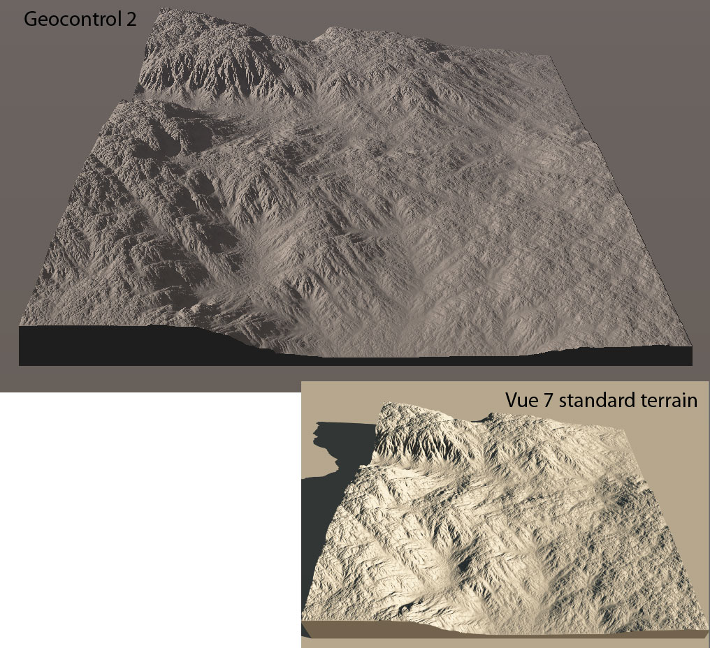

spedler ( ) posted Sat, 31 January 2009 at 11:19 AM · edited Sat, 31 January 2009 at 11:21 AM
Here's what I get (very quick lashup to demonstrate). First is the terrain rendered in GC2:
Now the Vue render from a procedural terrain using the 16-bit terrain height map exported from GC2:
As you can see, the terrains are almost identical apart from the artifacts in the top right corner in the Vue render (and the strange moire effects, don't know why they are there).
Edit: should have said that this is a 1024x1024 terrain, there would be better results with larger maps.
Steve
Paula Sanders ( ) posted Sat, 31 January 2009 at 11:24 AM
Spedler -
That is very impressive. Could you please do screen shots of the 4 views in Vue? I export the 16-bit height map, but cannot get the likeness that you are able to get. If you could provide more information, I'd appreciate it. What you have gotten is what I am now trying to do.
I have been trying to fill up the main viewport. It seems as if you aren't. Am I correct?

spedler ( ) posted Sat, 31 January 2009 at 11:44 AM
It's true I didn't fill the main viewport in that image, because I wanted to show how the GC terrain maps to a Vue procedural terrain. But you could fill the viewport, though some of the terrain would no longer be visible in the camera.
I've done a screenshot of the Vue windows but it's a big image so you can download it from my site; there are shots of the terrain editor and function editor as well if you want them.
Steve
Paula Sanders ( ) posted Sat, 31 January 2009 at 12:17 PM
Thanks so very much Spedler -
The Function Editor and Terrain Editor were identical with mine. The download screen capture gave me the starting point I was looking for.
Many of the other answers helped, but that download was what I was looking for. While mine didn't fill the screen either, it answered my questions and gave me what I needed to go on.

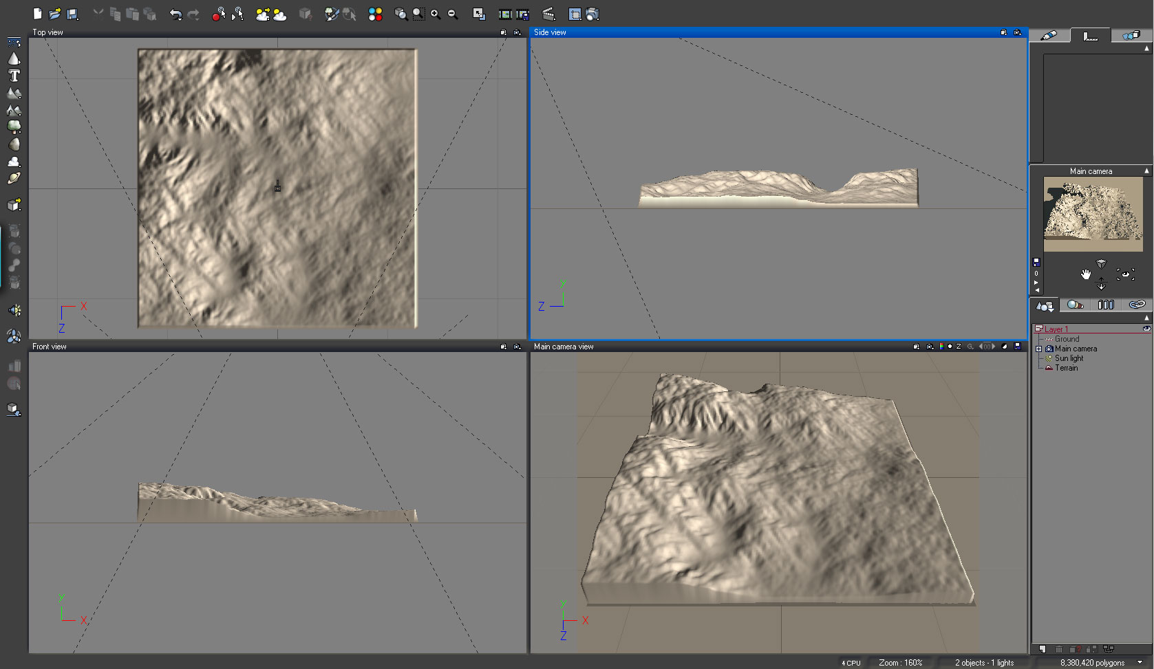

offrench ( ) posted Sat, 31 January 2009 at 12:21 PM
Here are my tries :
Geocontrol vs Vue renders
4 viewports in Vue
Try to use bilinear interpolation if you use images in procedural terrains. This may solve the moire problem.
That said, I kind of understand your problem is Paula. Geocontrol generates very nice terrains, but they generally cover large areas. Once imported in Vue, you may want to place the camera at eye level and thus have two issues:
  • you only see a small part of the superb terrain you have designed in GC2
  • you are so close to the terrain that you see artifacts as the area you visualize lacks resolution
I think GC2 generates terrains at a scale that is often too large for us, even when keeping the parameter: "Amount of details" to 0.
