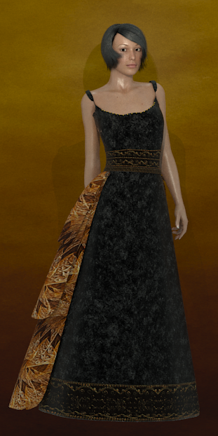

LuckDragon ( ) posted Thu, 26 August 2010 at 4:16 PM
Lux Render - was having some issues with the lighting, I'll end up redoing this one -
45 minutes
Poser - Firefly
