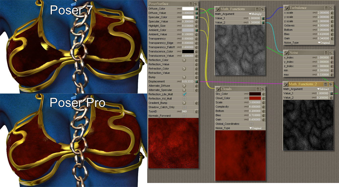

I just upgraded to Poser Pro from Poser 7 over the weekend and I've noticed that there are discrepancies with some of the shaders I use between the two applications.  I have attached an example velvet material, based on a freebie from RDNA, that appears much much too light/bright in Poser Pro.  I would like it to appear as it does in Poser 7.  I am using the same render settings (without gamma correction in Poser Pro), and even as I tweak the values of the various inputs on the nodes, it doesn't come out the same as it did in P7.  Can anybody offer any advice?

geep ( ) posted Fri, 27 June 2008 at 10:10 PM
The answer to your question may lie in the gamma settings, just a guess.

Giolon ( ) posted Sat, 28 June 2008 at 6:47 AM
I don't believe gamma will fix the issue, because it changes the entire image.  Thanks for the kind words, Geep.

geep ( ) posted Sat, 28 June 2008 at 7:14 AM · edited Sat, 28 June 2008 at 7:17 AM
Yes, you are correct.  I tried altering the gamma in your images 6 ways from Sunday and could not make any correlations to gamma corrections.
Observation:
There appears to be a distinct difference in the amount of gold showing in the center (on the left side).
Any reason for this?  Did part of the gold object get shifted on the zAxis?

bagginsbill ( ) posted Sat, 28 June 2008 at 7:52 AM · edited Sat, 28 June 2008 at 7:53 AM
You're using displacement and noise. There is an open bug on this for Poser 7.
Your old (P7 render) image is wrong, whether you like it better or not.
Very soon, even Poser 7 is going to render that differently.

Giolon ( ) posted Sun, 29 June 2008 at 10:46 PM
Thanks for all the replies.  So is the bug in Poser 7 that the noise node does not interact correctly with displacement?

bagginsbill ( ) posted Mon, 30 June 2008 at 6:25 AM
"So is the bug in Poser 7 that the noise node does not interact correctly with displacement?"
Yes there is such a bug relating to noise and bump or displacement. I'm not certain it is the reason you see a difference, but it may be. Here is a thread about it.

Giolon ( ) posted Tue, 01 July 2008 at 12:17 AM
Interesting.  I had thought that the sort of checkerboarding/striping problems were due to the model, not P7 itself.  Well it's good to know that should be fixed in the future.  Sad about the particular look of the velvet shader being permanently changed though.  I'll have to work on tweaking it more.

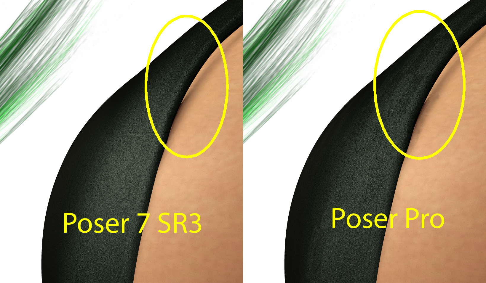

Giolon ( ) posted Tue, 15 July 2008 at 10:45 PM
Attached Link: Example 2
So, now that Poser 7 is post SR3 it's gotten rid of that weird tiled look on certain shadered materials, but it's still present in those materials in Poser Pro.  Ambient Occlusion is more spotty in Poser Pro also. Take a look at the attached link of a shot rendered in Poser 7 SR3 and Poser Pro.
Do we know if an SR is on the way for Poser Pro to fix the issue there too?

bagginsbill ( ) posted Tue, 15 July 2008 at 11:32 PM
There will be an SR for Pro. As a Beta user, I have it.
I don't see problems with AO or the tiled artifacts.

Giolon ( ) posted Tue, 15 July 2008 at 11:36 PM
Attached Link: The REAL Example 2
CRAP I posted the wrong example lol!  Too late to edit but here is the corrected Example 2.
