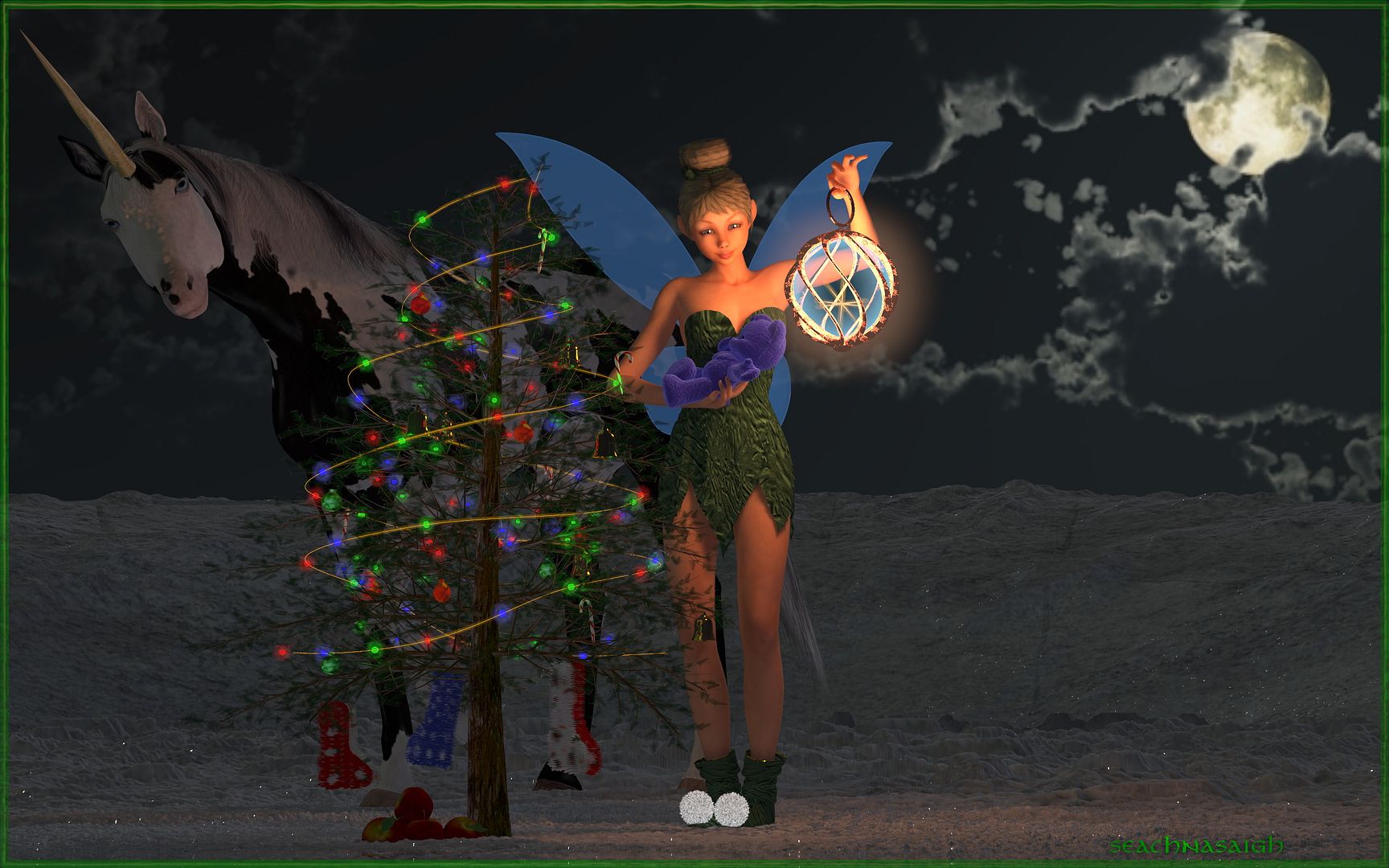

     What version of Poser are you using?  P8/PPro2010 have IDL capability, but are restricted in technique.  P9/PPro2012 and later are much easier to work in.  A candle would be doable in P8/PPro2010.
Christmas Tink. candle.

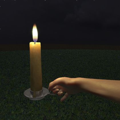

P9, PP2012, P10, and PP2014 can all use the same method of concealing the emitter.
     What type of candle did you have in mind?  The slender hand held sort as in the picture above, or a fatter table-top model like the one shown here:

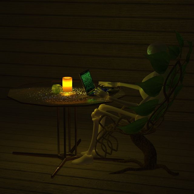

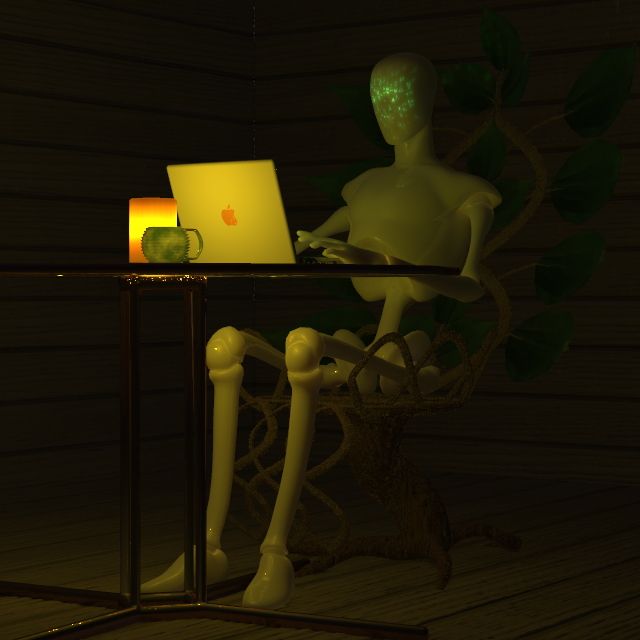

I have a guy typing on a laptop in a darkened room where the only light is coming from the laptop screen.  I have the laptop and I used a high-res square primitive sized to the shape of the laptop screen set as my light emitter.  The screen reflects GREAT in the eyeglasses I have on my figure but when I render it out, I have these disco-ball-like splotches all over the place.
Here are my render settings.
What am I doing wrong? (Poser Pro 2012.)  Thanks in advance!

seachnasaigh ( ) posted Fri, 25 October 2013 at 8:45 AM · edited Fri, 25 October 2013 at 8:59 AM
You need to increase the IDL quality.  7 just isn't enough.  Try 70.  Also 70 for irradiance caching.
     You might also consider adding a spotlight parented to the laptop and positioned facing out of the screen, using the monitor texture image as a "gel" for the spotlight.  You can get this effect of the monitor display projected onto the guy's face...
