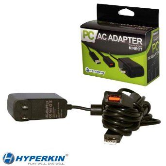

seachnasaigh ( ) posted Tue, 09 September 2014 at 5:45 AM
     You can use the Xbox sensor, but you need to get an adapter for it. The adapter provides power and adapts the orange Kinect plug to a USB.  It's about $13 US.
Xbox adapter.
     Other notes:
  •   Due to Windows' SDK licensing restrictions, SmithMicro does not officially support use of the Xbox sensor.
  •   The Xbox sensor cannot focus in close as the Windows Kinect is able to do.
  •   You can buy a near-focus lens for the Xbox sensor.
  • The new V2 sensor does not work with Poser Pro 2014 GameDev.

Oh, another thing you need to do if using an Xbox sensor:  download and install the Kinect SDK 1.8 (it's free).
