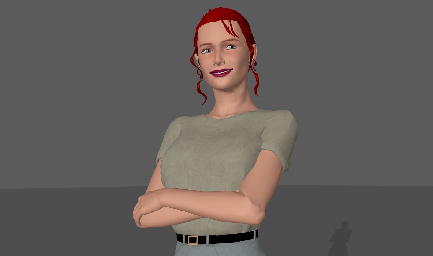

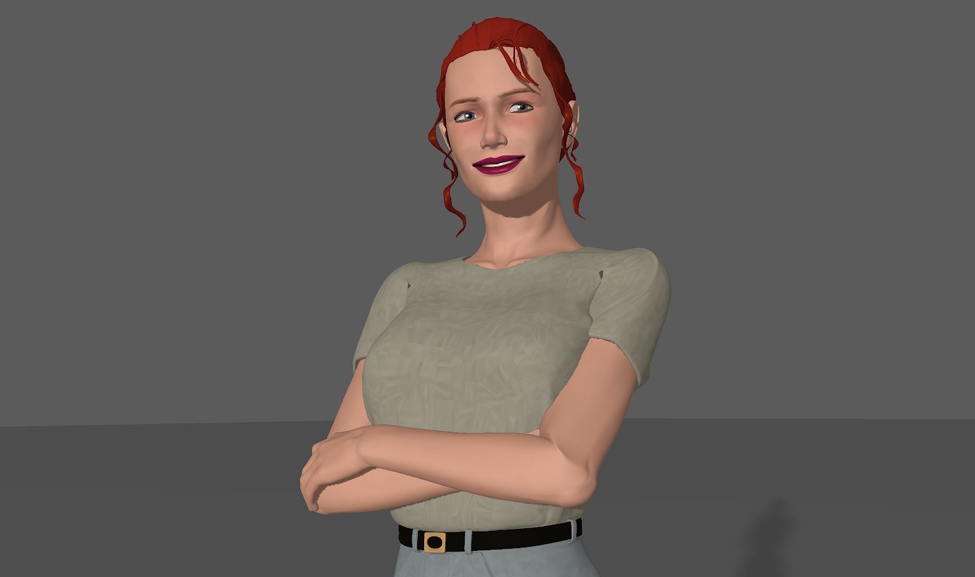

odf ( ) posted Fri, 09 December 2022 at 7:56 PM · edited Fri, 09 December 2022 at 7:56 PM
This is the kind of effect I was looking for:
Now on to figuring out how to do it in SuperFly, and then learning how to use Bagginsbill's Matmatic Loom. 😄

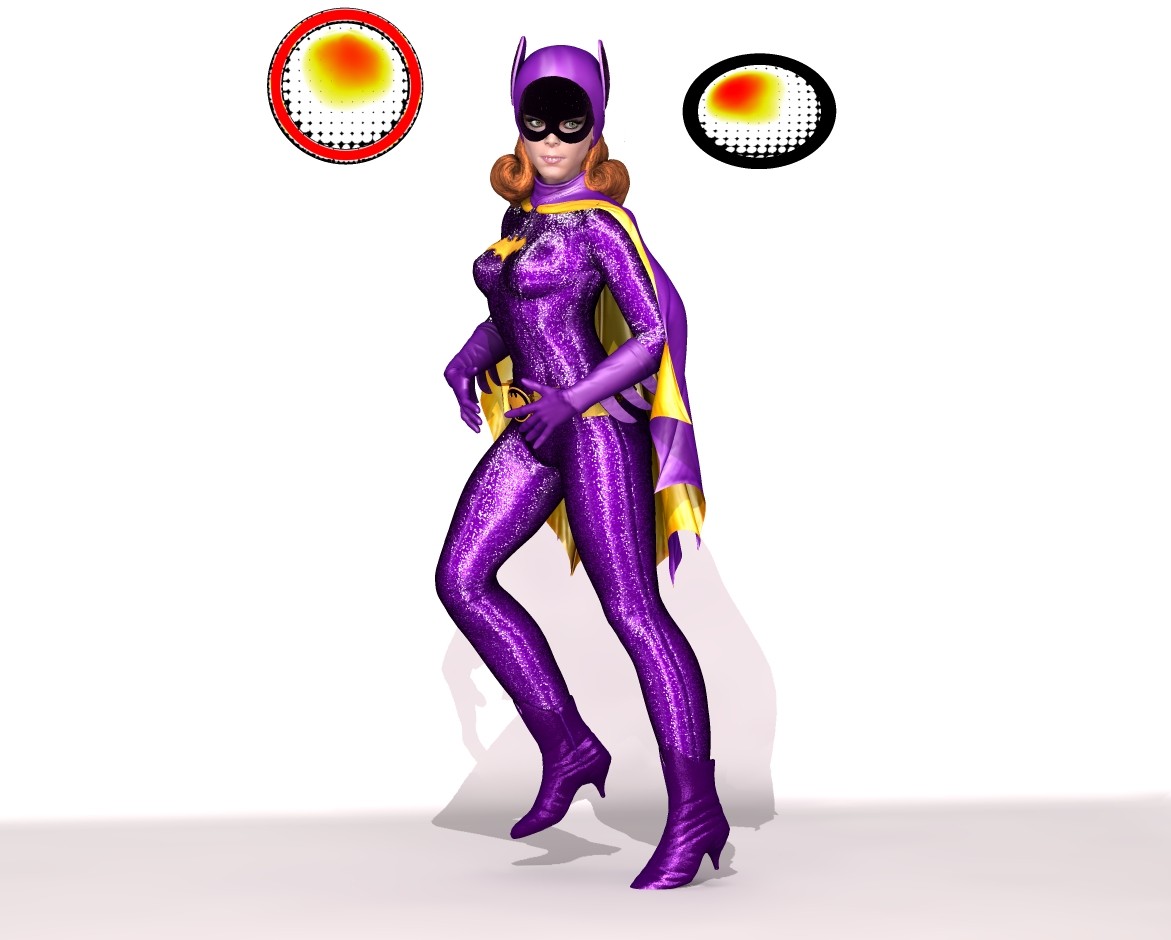

Cage ( ) posted Fri, 16 December 2022 at 2:08 PM · edited Fri, 16 December 2022 at 2:08 PM
This got me pretty excited, so I applied this new solution to the two-sided cloth cape problem I was having in that old thread, to which BB posted the Z-axis solution.  This looks really nice, until something casts a shadow on the backfaces.  Then it has a panic episode or something.  Rats and mice.  Now I hafta file this under "No Dice!  Cartoon characters aren't anatomically correct!"VvYz1kOqiEn5neJVCFHS4UO7gpQWSOoInfQ9VV5r.jpgup76SxIH0KZ8U8HQieWKwxGs0Hn0vFgp88tWDkfZ.jpg

primorge ( ) posted Fri, 16 December 2022 at 2:29 PM
Weird that the shader back face "poke through" isn't matching the cast shadow shape... I'm confused in general by what's going on in your screen captures. In one instance it's showing the cast shadow fine (bottom left) and in bottom right it's not?
odf ( ) posted Fri, 16 December 2022 at 4:26 PM
Cage posted at 2:08 PM Fri, 16 December 2022 - #4451874
Yeah, it's tricky. You'd need to make sure the front side has some light on it everywhere, but as bagginsbill discovered, can't use indirect light.
Once again, SuperFly wins. :-P

Cage ( ) posted Fri, 16 December 2022 at 5:49 PM · edited Fri, 16 December 2022 at 5:51 PM
primorge posted at 2:29 PM Fri, 16 December 2022 - #4451880
Oh, right.  I got distracted and forgot to label the lower one.  On the right, I had deactivated shadow casting for the light in the scene.  I don't know why it looks like there's still a shadow.  On the left, the shadows are activated again.  I'm not sure these are good examples of the problem, now that you point it out.  The trouble does relate to shadow-casting, at any rate.
Edit.  The problem may be the IBL, in fact.  Interesting & weird.
