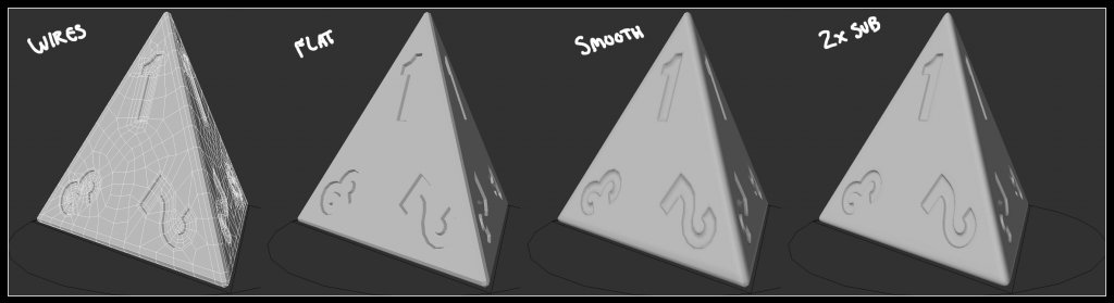

LuxXeon ( ) posted Thu, 24 July 2014 at 10:46 AM · edited Thu, 24 July 2014 at 10:47 AM
Depending on the application, the pyramid isn't really much of a challenge.  The package I model with, for example, has a pyramid primitive object, which has many options for creating various pyramid shapes instantly.  This one is just a simple 4 sided pyramid, with quad chamfered edges.  I could easily quad the centroid triangles if necessary (subdivision), but I don't see a reason to.
The text (for time sake, I just re-used some numbers I already made in one of my other freebies, I simply use spline text (any font I wish), then extrude the spline into polygons, and connect edges to quad it up.  This could become time consuming, but not difficult to achieve.  Again, it depends on what your modeler is capable of doing.  Some packages without the option to use Text as splines might have a more difficult time.
BTW, all quads, except for the triangle faces, but I could quad those up if necessary.

LuxXeon ( ) posted Thu, 24 July 2014 at 10:50 AM · edited Thu, 24 July 2014 at 10:50 AM
Edit:  If you want the numbers inset, instead of looking extruded, then you can just connect them to the triangle sides with a cut tool, using the extruded numbers as your template for cutting the edges.  Yes, this would be time consuming, but not impossible.  I guess if you needed this quick, then you could simply boolean the numbers.  I just think the results would be very poor topologically.
Depends on your needs really.  If I have time later, I'll do an inset version for you, with the sides all connected to the numbers, but I just don't have time right now.

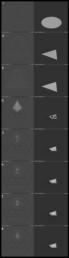

 Note - All rotations in all steps were done from the origin/zero point of my object. All the images should be clickable to view larger as well.
Step 1 - Make a 3 sided circle, or pick 3 points from a 24 sided disc which ever floats your boat, so long as you arrive at an equilateral triangle. [You software may even have a shiny tool just for that.]
Step 2 - I subdivided it once, and sliced near the bottom edge three times, rotating it between each cut. Those slices will act as my hold edges later on, how close they are to the edge of the triangle will determine how sharp the edges of the die are.
Step 3 - I subdivided it a bit more, making sure to keep my hold edges in the same place each time. Was a rough guess at this point how much geo I'd need, but figured that would be plenty.
Step 4 - Made the first of the numbers, and patched into a segment of my recently subdivided triangle. So long as you stay within the highlighted "diamond" shape, it really doesn't matter how ugly your geometry is [within reason], you won't see any errors in the final model.
Step 5 thru 8 - Repeated creating and patching in the rest of the numbers. Now I've got a full set of 4 numbers in diamonds that fit my triangle very neatly.

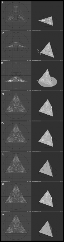

Step 9 - Selected three of my four numbers, rotating them from the origin as needed to make one complete triangle/side of the die. First face was 1,2,3.
Step 10/11 - Rotated my 1,2,3 face 70.529 degrees so it was upright, then using a snap/align tool moved that face corresponding corner of my triangle.
Step 12/13 - Repeated the process of making the face, rotating it upright, snapping it into place, then rotating on the vertical axis as need till I had all three sides. The last face, [2,3,4] remains on flat on the surface, tho it did need to be flipped 180 degrees because I'd modeled it facing up, and it needed to face down on the actual object.
Step 14 - Merged points/welded with a tolerance, whatever you wanna call it, and subpatched the mesh.
Step 15 - If you notice the points in step 14 they're a little ugly. So I tweaked my hold edge set up a little bit. and softened the points some.
Step 16 - Those points are better, all done!

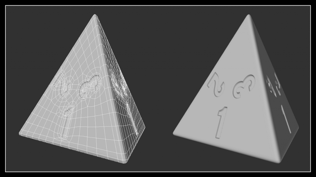

 The wires could be a little nicer, particularly around the numbers but it'll render fine, and I wasn't fussed too much on perfect geometry. Polycount is 3288, all quads.

Thanks Warlock that was a most impressive tutorial.  You know I could have sworn some of the 4 sided dice had a single number. Checked my old D&D dice and sure enough every one was 3 per side. My bad. :)  Well off to see if I can replicate the same process.

Wow.  Very impressive, Warlock.  I had no idea thes dice have 3 numbers per face, and I never bothered to check.  Just dove into what was being asked here in the challenge.
Great approach to solving the mathematical end.  I'll give it a go also when I find some time.  Wel done, and looks fairly easy.
