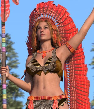

I've continue on the process to bring Genesis 3 into Poser 11. I've setup the scale and translate vertex weight maps for all the 66 facial bones. I found the translate weight map need to be set to 15% intensity to match how it looks in Daz Studio. Scale weight maps work fine at full intensity.
Now, it comes down to distribution. I need a script that would add the SmoothScale and SmoothTran parameters to the body parts and the weight maps. However, I can not find a Poser Python method to accomplish this things.
Does anyone know a way to add the SmoothScale, SmoothTran, and Weight Maps with a script?
WandW ( ) posted Sun, 20 December 2015 at 10:05 AM
Nice Work!! 😀
DAZ has liberalized their EULA since the V4WM days, so you should be able to distribute it as a cr2, with instructions on how to export the .obj from the user's copy of Genesis 3 and where it goes. (actually, the .obj can probably be copied from the user's auto-adapted folder after loading Genesis 3)
Here is the EULA; the relevant section is in Section 1.0, Three Dimensional Works...
https://www.daz3d.com/eula
lululee ( ) posted Sun, 20 December 2015 at 1:07 PM
WOW, willdial! What an accomplishment. She looks great. Looking forward to your script or cr2. Cheerio lululee
